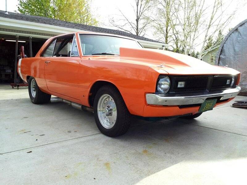

Here's the set of 12" wide I swapped pieces around to get the offset I wanted for my 74 Duster that's tubbed to the frame rails.
I would be ashamed to tell you how many hours I worked on these and the amount of money I spent, but I got what I wanted.
Tom
WOW, those are NICE!
