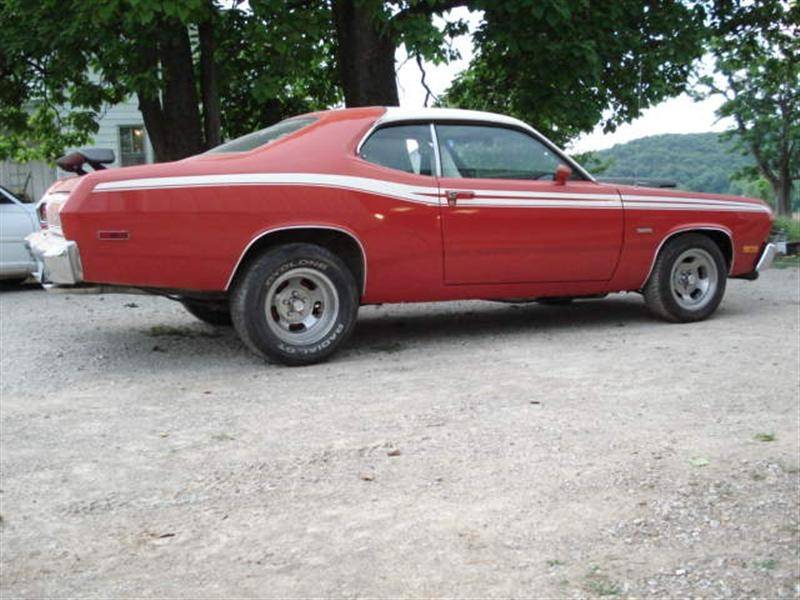

I Am Running 295-50-15 On 15x8.5 In Slots On My 74 Duster And Am Running 28x11.50 Hoosier Slicks On 15x10 In Convo Pros with 5 in backspacing On My 73 Duster.all Stay In The Fenders With No body modifications or spring relocations.heres A Shot Of The 295's.ill Try To Get Some Shots Of The 28x11.5's This Weekend
