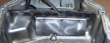

Need Input on tank baffles.
Here are photos of what I have laid out.
The holes will be 1".
I have the holes staggered from side to side.
attachment.php
attachment.php
attachment.php
I need to know if I have too many, not enough, too large, too small of holes in the baffles.
Thanks,
Herb
i would come up taller and I would also create a baffle around where your sending unit is going.
I can't come up any higher from the pump to the end of the pickup due to the spare tire cut out.
I don't think the fuel sending unit will need a baffle. The float will run side to side along the rear of the tank. Also the factory never saw a need for a baffle around the sending units and they work fine.

You may be a bit generous with the amount of holes you have. I think the fuel would tend to just run straight through. The trick tanks have hinged baffles that let the fuel in but not out. I would highly recommend the anti-slosh foam in the non-sump area...it makes a BIG difference in keeping the waves to a minimum.
Ultimately it might be beneficial to have a sump area in the tank for your pick-up (small boxed area lower than the rest of the tank)

Foam is not an option in a fully TIG welded tank. The holes are very generous. Most of what I see are small slots along the bottom of the baffles but I'm no fuel tank design engineer, lol. The hinged baffle deal is interesting, and I've seen that in oil pans but I've never seen it in fuel cells.
