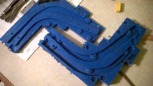

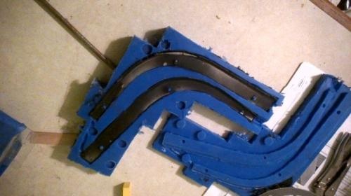

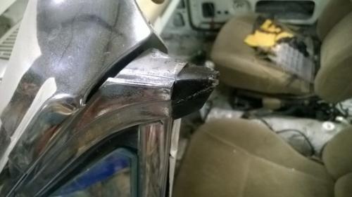

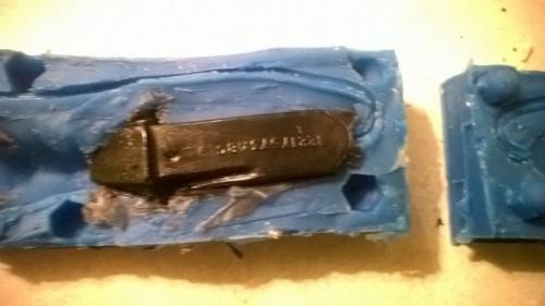

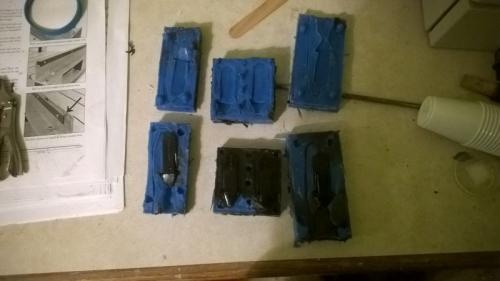

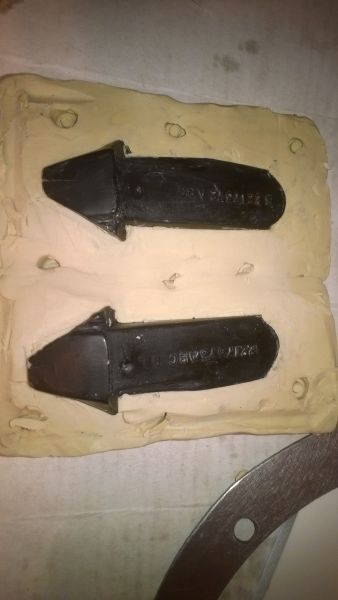

now that I have been home and relaxed for a couple of weeks or so, I started working on a couple things that needed to get done.
1. those plastic side trim panels for the rear side panels are now going to get .090 plastic. .060 just stretched too thin. if .090 doesn't help then I'll jump to .125 but the shape is dead on and fit is GOOD!
2. divider cushions for the front window for the convertible molds are made and a couple of test pieces are made. fit ain't too bad but the hardness is suspect. really soft for a shore 60a.

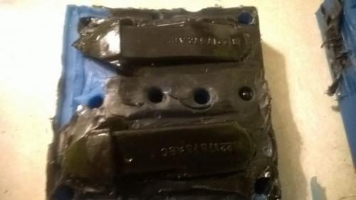

I am going to get some harder urethane about to shore 89 or more just to make sure it works good.

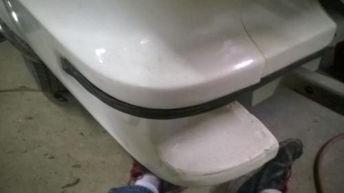

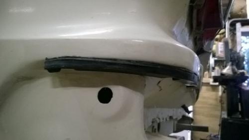

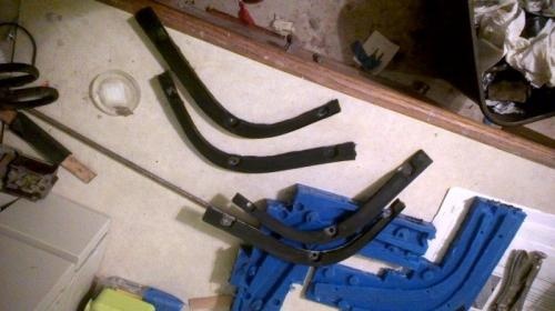

and then I got the rear bumper cushions made for my darts
these I like! still a little ragged around the edges but a sharp x-acto blade can cure that.

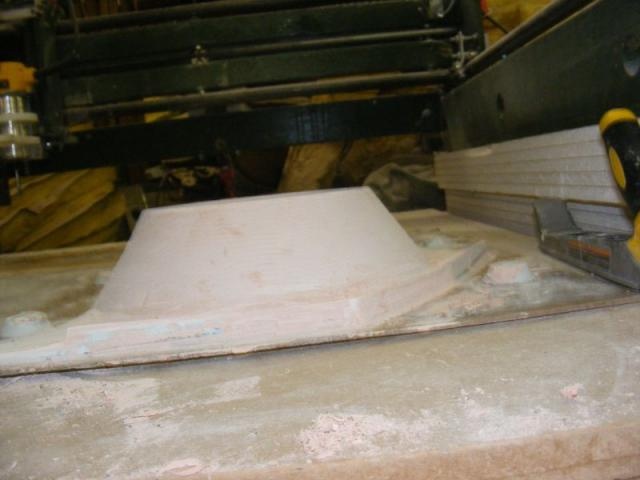

Man it's been a while since I was able to get back to the kick panels. But I'm back on em for a bit. Here is the deeper drivers side kick panel mold taking basic shape in foam .. I just got my new 3d software and am playing with that to give me a better finished looking part
I just wasn't as happy with the slimline version speaker choices so I decided to make it a bit deeper. total depth should be (after top coating the mold) should be 2.9 inches to the top flange and accept 5.25" speakers plus 2" mini remote speakers. that should broaden out my speaker choice for the kick panels.

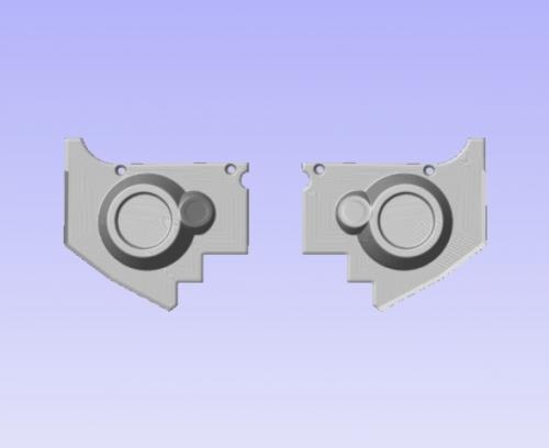

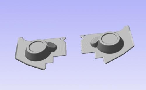

and last but not least the rendering of them

got most of the rough work done today. I will have to fill a few voids that happened and some light sanding to smooth out the transitions, but all in all it's starting to look oretty good as a test.
so it was first an idea, then a model and now it's going into foam.
the start
the shape
rough cut
final rough cut . finish cut will have to wait for a bit. (or I just might sand it to where I want.:D)
then I will mount it on a plate and raise it to the height that I need for the vacuform to work and test it in ABS.
