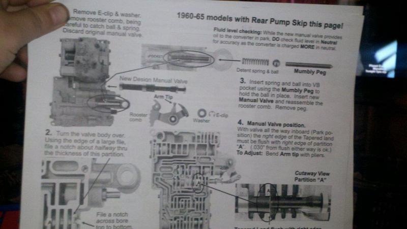

I have to say Im reading the directions and im lost. Anyone have any good videos or know any good tech articles? Being honest this looks out of my relm.
What I dont want is a manual valve body. I want the firmer shifts with out going full manual. I want the trans to be able to shift through the gears on its own.
On the first photo. Does this mean this will make it a manual VB?

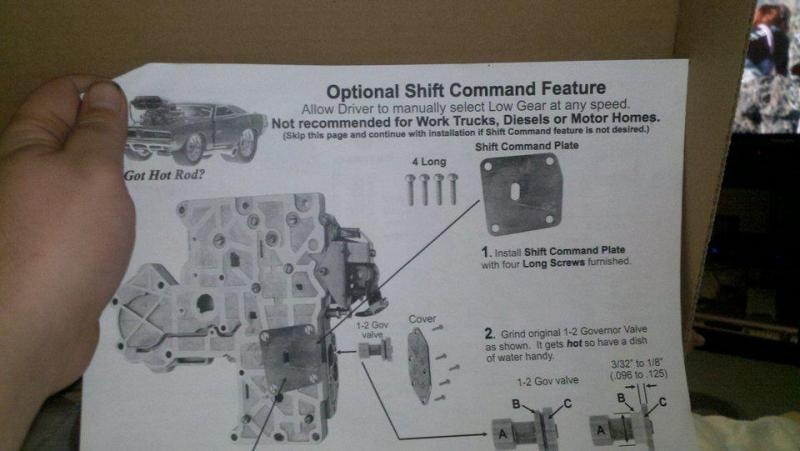

Second photo. It says optional. DO I need this option?

...............No, a -2 is not a full manual kit.......[u would need the -3].........the plate and valve modification r if u want it 2 shift 2 manual low at any speed and yes i do mean any speed when u shift 2 1st it goes there regardeless of speed.......i almost always do that modification........when in drive ur trans will shift on its own......if u have the control load servo up front 4 the 2nd gear band u will need change it....or modify it........kim........u can do it, just re read the instructions over a few times as there is some modifications 4 street and strip......
