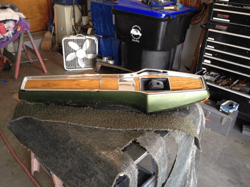

I know it isn't original/stock, but I used real wood on the 4 speed 69 Barracuda console. I bought a small roll of real oak veneer at Lowes. It was pretty thin; maybe 1/16". I made two one piece templates from thin cardboard. That was the hardest part. Then I transferred the patterns to the wood and cut it out with a razor blade cutter. Once the fit was perfect, I stained it and sprayed a few coats of gloss clear urethane varnish on it. Then I glued it on with contact cement. It looks really good, even after 20+ years.
