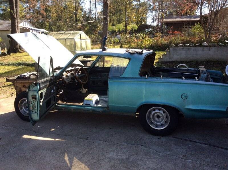

Here is my 73 Dart Sport with sunroof structure showing where the shoulder harness attaches.
