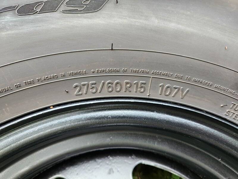

I am going to buy a new set of rear tires and I wanted to hear from you guy and gals on your tires. Currently I am running 275/60/15 Goodrich tires and these are the worst for the track. They will spin on the launch every time. My car is a 74 Dodge Dart Sport with a 408 engine.

I’ve run Goodrich and nitto drag radials on the street. I liked the nitto a little bit better. Never ran them on the track and I had 325 hp max. Be aware 5k and most the tread is gone. They will go a bit farther but bald. And bald tires suck on the street if its your daily driver.
I would lean to the Nitto drag radials. I have had them on several street cars.Last longer on the street than ET streets. They kept me from doing burnouts too and that saves me from getting tickets.
Funny, I have a pair of mickey’s and have never run them.
The wife has the above Mickey’s, pretty good tire. We like it. On my Duster, I have Nitto 555 which are also very good. I think the 555’s have the edge at the track.
Mickey Thompson ET Street S/S. Dead hook at the track only needing short burnouts just till you see smoke. On the street it depends on level of power and how you hit them. Best method I’ve found for my setup and only way I flog them is strictly from a roll. Otherwise they will spin and never recover until I let off some for them to grab. Still better than any pure street tire. Only downsides about these tires is tread life. Not very long, not good in rain (why would anyone drive in the rain anyways, especially with no wipers!) and cost. I use them for the track only atm.
Nittos for me 325/50 r15's Standard width axle housing with springs relocated 3" inward and 15x10 cop wheels!
