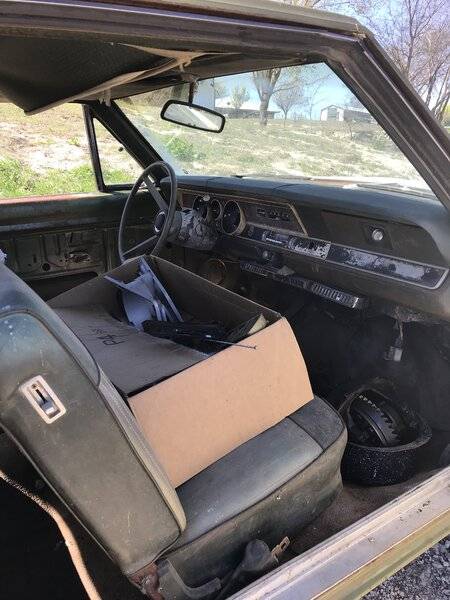

Thanks. My trunk lid shown in the picture.
The car is a H code. The deck lid has been changed out at some point earlier in its life.
