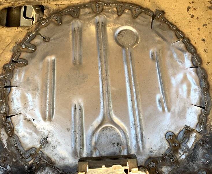

So I thought I would add some more information here. I bought one of the Sherman spare tire well replacements. Now, I flattened it and used it to make the trunk floor in my Duster flat, but I think a lot of the same stuff applies. The Sherman spare tire well is not an easy installation. It will take a decent amount of work to get it to fit and look right. It also takes A LOT of welding. Yes, my install took more, but on the plus side all the welding I did was flat, where if you use the spare tire well piece to replace the spare tire well you will be welding in the vertical section of the tire well the entire time.
So, what I'm saying is that given the choice between installing a spare tire well section, or the entire AMD trunk floor, I'd install the AMD full trunk pan every time. EVERY time. It's less work, it's less welding, and it will look better when you're done.
I cosign with the above. Welding in a spare tire well is a lot of work for a second rate looking job when you're done. You might pay a couple hundred extra for the whole floor but the amount of time it takes to install it will be hours and hours less, while it will look a million times better.
I butt welded a spare tire well panel in mine around 2009 or so. The seam is a couple of inches up so hard to see from under car. My body was bent over like a U while butt welding that seam from inside trunk. It was was super difficult. I am happy with how it turned out. But full trunk floor would have been way way easier.
