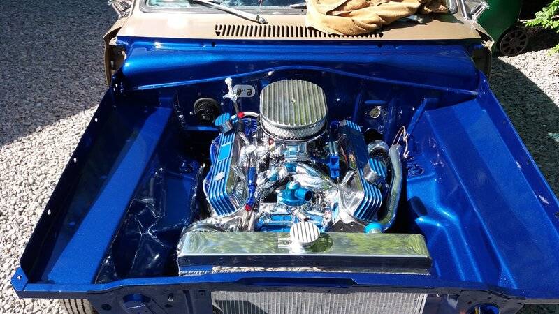

Very nice looking.
Put Doug's on my 64 Barracuda.
Fit great,look great,good ground clearance,no lower than pipes under crossover.
