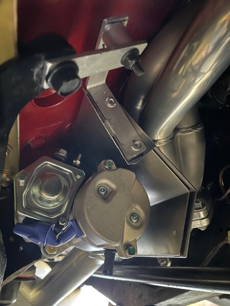

OK, I bought a heat shield for a 350 chevy ('cause they make everything for that and 302 Ford) and adapted it for my 360. See pic. Problem solved. Took it on a long drive, let her sit to heat soak good, starts right up. So, it was indeed the heat from the header cooking my little mini-starter.
So, even though I have the exact same configuration as Darter6 (see above), my engine is putting out more heat. Could be that it's a new build, could be that it's a fire-breathing 375 hp beast. Again, the timing is set correctly.
