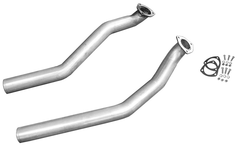

Here's a pic of the 2.5 Adapter pipes TTi supplied with my shortie headers.
Very well made, fit is excellent with no dimpling or hammering required.
Easy install when done according to TTi instructions.

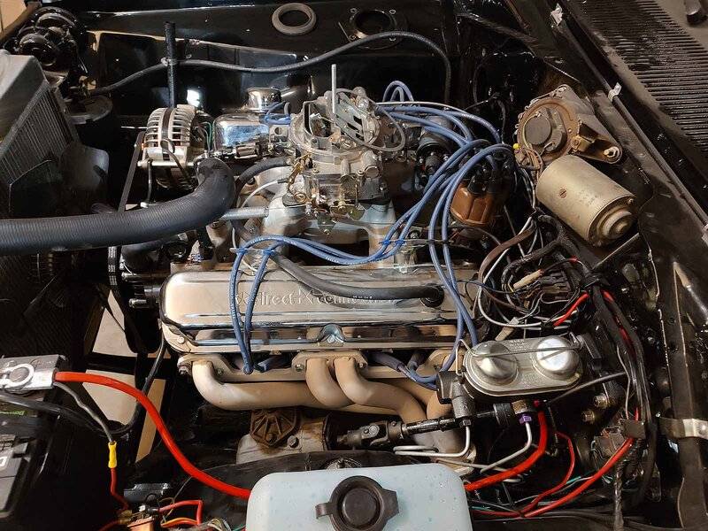

Just a note on TTI shorties. I am putting a set in my 74 Duster (360 with a Tremec TKX) and am making mods to my zbar and clutch fork to get enough room for the DS adapter pipe to fit between the clutch linkage an torsion bar. Had to get a short clutch fork in the hope that it provides needed clearance.
My 340 didn't come with any manifolds so when it came to exhaust I opted for the TTI shorties since either option was going to be pricey and I'll go with the performance bump (and sound) of headers. It's a 4 speed car and the fit of the extender was a little tight on the left side but it was certainly doable.
