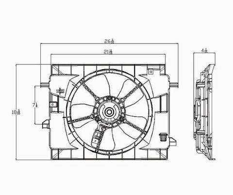

I have a 2007 Chevy HHR fan on my 408. It fits a 22" radiator perfectly, complete with shroud, for just over $50....can't beat it.
Do these dims look about correct?

Here is one image I found on the web with measurements.

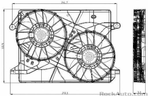

on my 96 Dakota race truck I am building with a warmed over 360 magnum. I ended up getting a fan set up from a 06 5.7 hemi dodge charger to fit. But I did have to trim it some to get it to clear my electric water pump. the fan is only 3.1 inches thick. I found out the is not a whole lot room up front on a Dakota.lol

I used the HHR fan as well, but didn't want to cut the shroud. You can't uncut it, and I was able to make adapter blocks to use the factory shroud mounts.
They're 3d printed in PLA for now, just prototypes, not sure if I'll print them in ABS or make them from aluminum for the final version.
I did have to shim the fan motor fwd to clear the water pump. I'm thinking about either a magnum serp belt conversion (need a bigger ALT anyways for the EFI, fuel pump and fan) or modifying the existing pump housing and shaft to shorten it, similar to a magnum pump.
