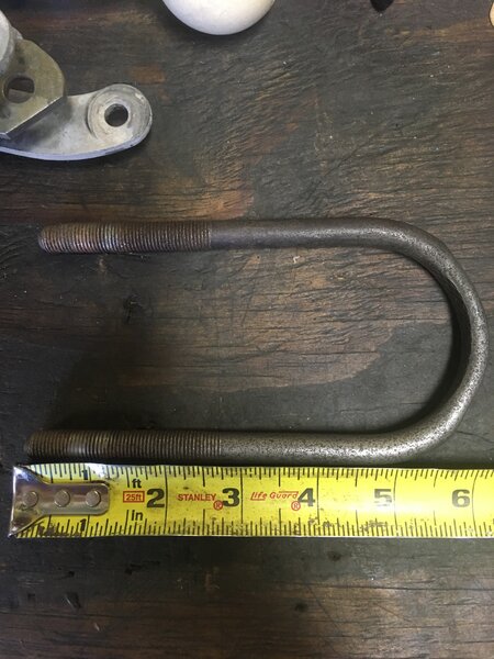

i've got 6.12 OAL and 5.75 IL crotch to tip
OK, I can get the tube diameter easy enough but still need stock diameter, 7/16" or 1/2" , NF or NC ?

i *think* they're 7/16 but they are for sure NF.
if you're not in a rush, i can measure later today and see if its three siblings are kicking around here somewhere.

The rear spring clip, or U-bolt, for the 1975 7-1/4" A-body axle is 5-3/4 inches length, 7/16" diameter, with 7/16"-20 threads. The length is the straight part of the U-bolt. The length including the saddle portion is ~6 inches. The spacing of the U-bolt shanks for the axle tube is 2.75 inches.
The original part number of the U-bolt is 2834928. The 7/16"-20 nut original part number is 6023018.
The rear spring clip, or U-bolt, for the 1975 7-1/4" A-body axle is 5-3/4 inches length, 7/16" diameter, with 7/16"-20 threads. The length is the straight part of the U-bolt. The length including the saddle portion is ~6 inches. The center to center spacing of the U-bolt shanks for the axle tube is 2.75 inches.
That covers ALL the bases. Thanks
