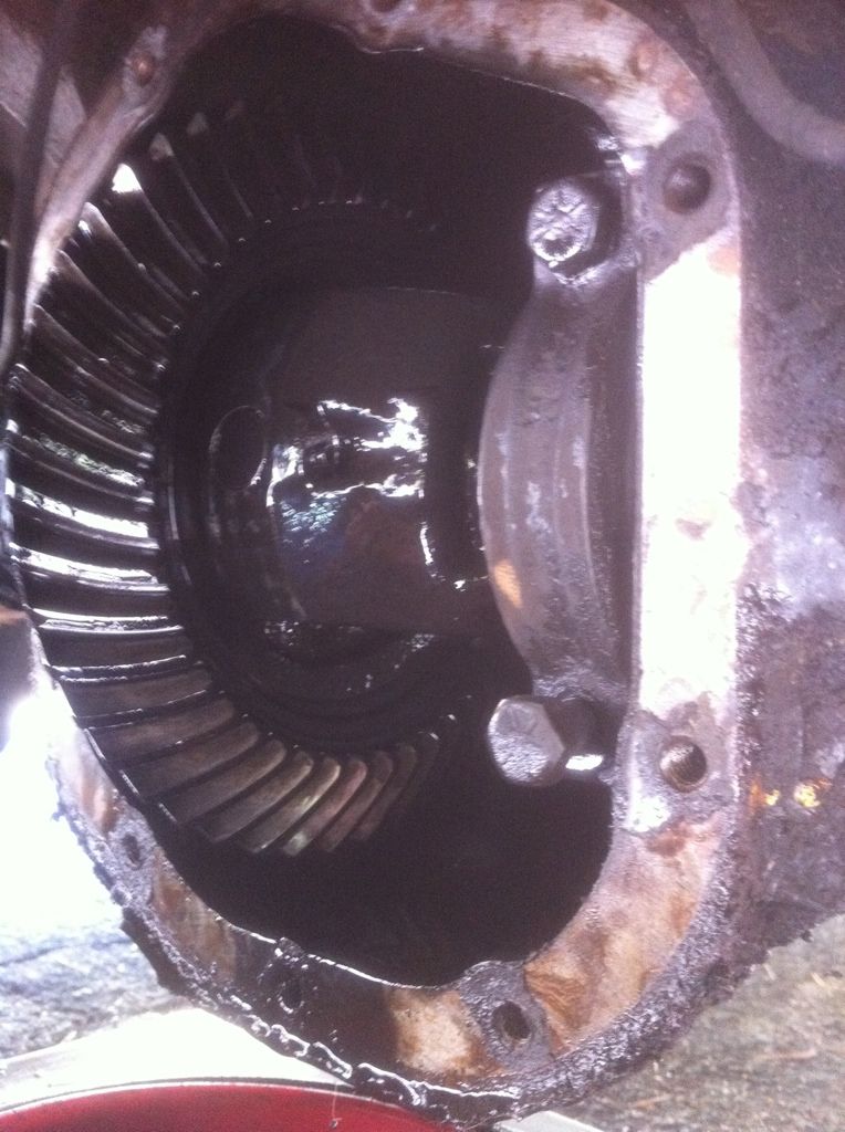

Uhh, I dont think this is right?

Im no pro but I think this bolt should be tight?
71 dart 7 1/4 rear, anyone got a torque value on this sucker?
thanks again.
"71 dart 7 1/4 rear, anyone got a torque value on this sucker?"
40 ft lb out of the 71 manual
