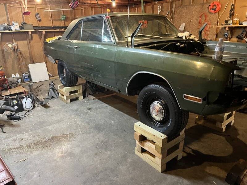

Doing a hellcat swap in my 70 swinger. Looking for some affordable aerosol type or brush on undercoating material for wheel wells. Anyone have any budget friendly advice. No air currently and the nice stuff like raptor is just to pricy. Would love some feedback on products you have used and found satisfactory.
