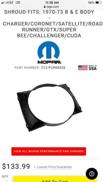

Overflow connector on neck preventing the use of the stock original. I don’t want to cut the original from what I can tell before pulling it apart.
Anyone have a recommendation of a black universal shroud to work with the stock 7 blade 18” fan?
A thought... wondering what others have done. I was thinking if the MP one can be used?

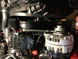

I bought one from a 90s dodge truck at pick & pull. I modified it to fit a 22” radiator. Also bought the 7 blade fan and clutch & pulley. Think I paid $30 for all of it. Just dumb luck it all fit.
I just modified the original shroud by enlarging the mounting holes with a dermel. I couldn’t find anything to fit the 26” 3-row that was not a cheap looking universal shroud.
Do you have any pics on this ? Was it a Dakota or full size truck?
This is the only pic I can find right now. You need a shallow one that leaves the fan blade half way out. I don’t remember what truck it came off. They are also on some 80s V8 passenger cars.
