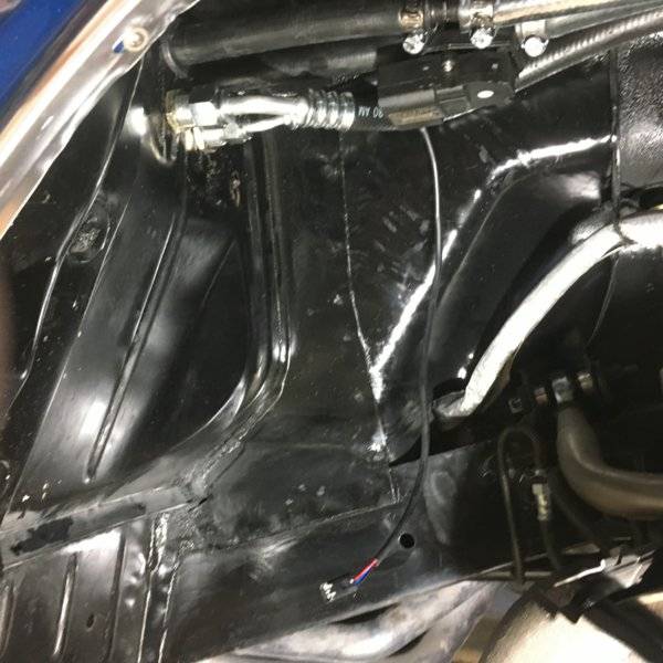

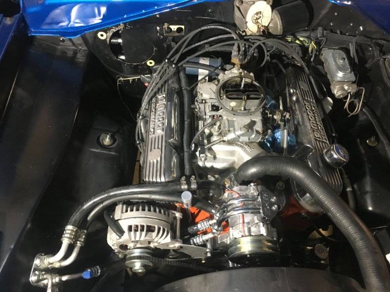

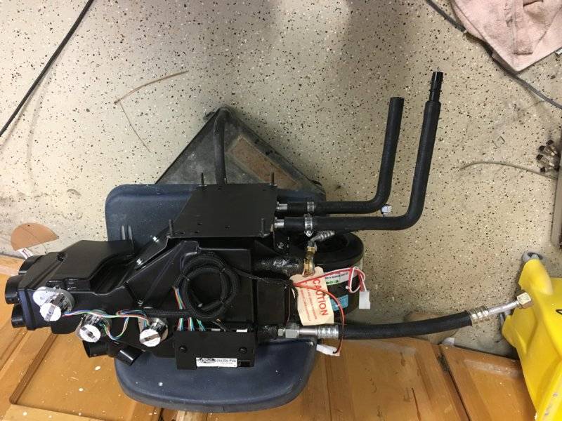

I have a 67 Dart. This is what I did with a new Vintage Air Gen 4. I have an ac car and the new box barely fit under the dash to make all the connections work. There was also no kit for my car. Good luck. Let me know if you have any question.
