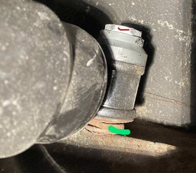

Anyone have any idea what this grey metal cover is preventing access to the rear upper shock bolt? It can twist with vice grips but won’t come off? Advice needed
That spacer is used for coil overs or air shocks to move the shock away from the gas tank. Yours are on the wrong side of the shock. That skinny nut that looks rounded in your pictures should turn off. Here are pictures of what the parts look like. Left side is factory right side is with spacer

It's not breaking loose because you're grabbing the spacer WITH the nut. Just grab the very thin part on the outside. That's the nut. It should break loose then.
Can you feel the end of the bolt in the end of the nut (with red mark)
Does the green mark part turn when you turn the red mark part?
yep, that is a spacer for air shocks (HiJackers I think) but it is installed in the wrong place. It was supposed to shim the shocks away from the crossmember, but this just acts as a giant washer
Ok I discovered the bolt in the trunk and then removed the whole thing...was then able to get a clean angle on the nut to remove it....it was metric to boot!
