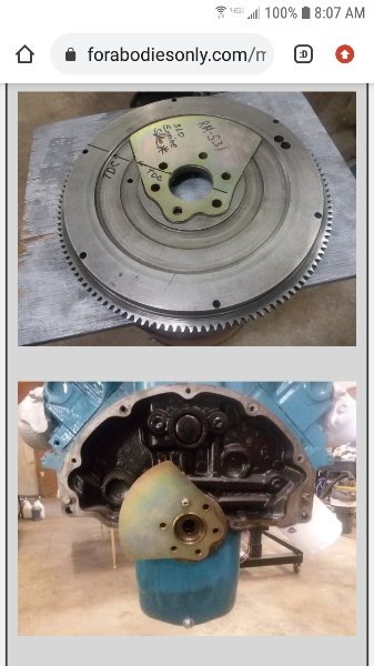

Using balanced flywheel on a Magnum 360
It's really something, every supplier I checked has discontinued that 360 balance plate, all across the board.
They definitely work as I have run a 360 with a neutral torque converter and trans on the floor just to hear that it would run. Shook just a little kind of like a miss at low rpm/idle.
Then I ran a 360 stock build on the Engine Run stand with the balance plate and it ran nice and smooth, no shaking.
Kind of wonder why demand dropped off so quick on those? Now none to be found.
Unless they all got bought up what was left of the stock after they stopped making them cause people wanted them for the 360s.
They really need 1/8" longer than stock crank bolts to hold properly for the long haul.
Sure would be easy to duplicate them if a person had the part in hand.
Always learning something...
