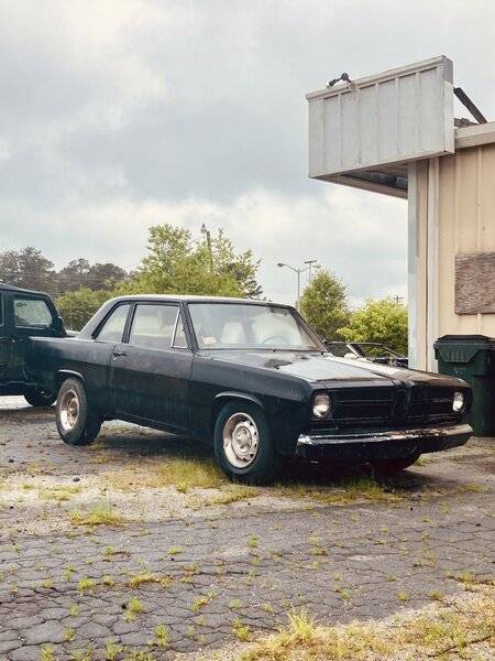

So I have acquired a ‘67 Valiant recently, and while it’s not currently the project I am focusing on, I have been trying to build a plan in my head of how I want to do it.
My current curiosity is to what front clips, (fenders, nose, hood and grill), can I swap on to this body. The valiant front end is kinda dowdy looking as is. Will a early duster front clip go on? I really like the shark tooth grill! Or maybe a ‘67-‘69 barracuda front clip?
What fits?

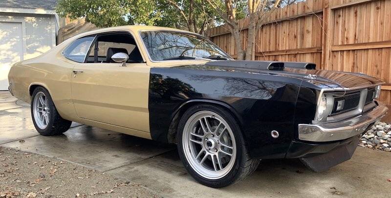

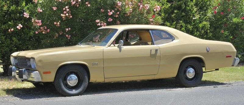

Pictures of valiant/duster swaps here
72 TO 68/9 TRANSFER
And my ‘74 Duster into a ‘71 Demon…
