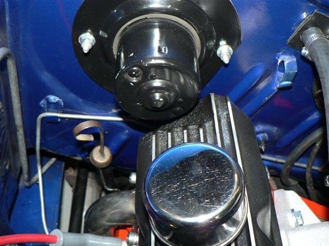

I know you said you weren't wantin to get into cuttin and weldin...but this is a clean option.
attachment.php
I think a good welder would be very reasonable. It's a small area. ...and I'm sure Cudachick would hook you back up on the finish end.
