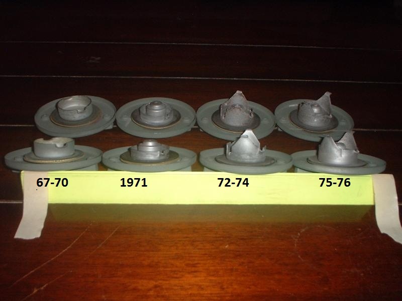

"OldmanMopar" I believe showed the differences in caps. This is determined by your FILLER NECK. These are NOT vented. They are known as "pressure vacuum"
72blunblu it turns out............
http://www.forabodiesonly.com/mopar/showpost.php?p=1969928450&postcount=6
attachment.php
The venting in those with the "pressure vacuum" caps is done by means of the evap vapor control system.
Figured it out with help of Year One, changed from old style to newer style in June of 71. Our car was built in December of 70 so I got the older style.
