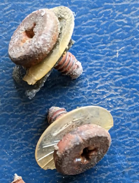

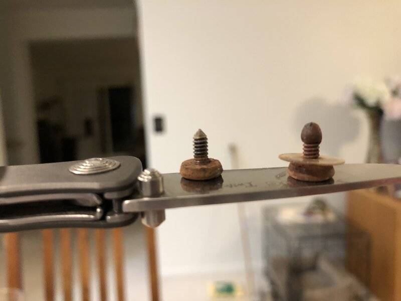

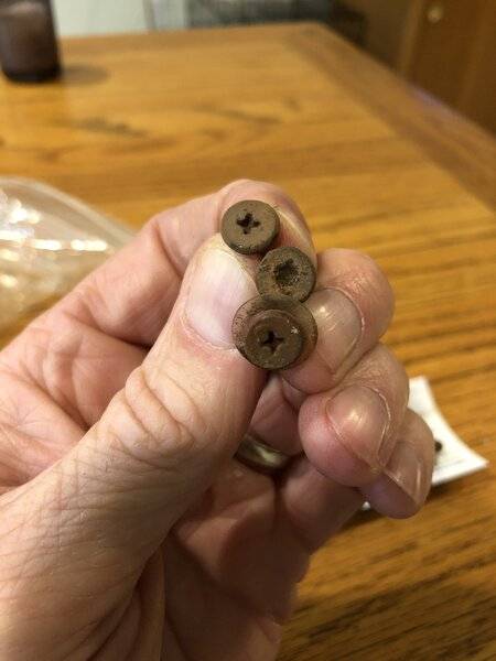

The car is a 1970 Dodge Dart. This is NOT about the readily available trim clips that bolt on at the bottom of the back window!!! On my C pillar the trim is secured by odd screws that the trim clips directly over the head.
Below are some pics of the old rusted screws that came out. Again, there is no molding clip attached to these screws, the vinyl top trim just clips right over the head of the screw. Anybody who knows where to find/look for these, I would appreciate you responding on the thread. I've been looking for months! If anybody even knew what the name for a screw head like this would be, that would help. The head is exactly 5/16 of an inch wide at the widest part.
Thanks for any help!!!!

That's them!!! and yes about half the ones I removed had thin clear plastic washers on them, which promptly fell apart. I think they keep the trim itself from damaging paint/vinyl when installed.

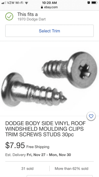

This a screenshot of what the seller dith612 has on eBay. You can see the threads stop. Someone else on here found these in another thread. No mention of head size but looks the part.

These are designed to hold a clip and not the trim directly, if you look at the original posters screws they have a chamfered head and are a different diameter. I tried these and they do not work.

So, you were the one who found these. Yes I see the chamfered head on our used screws. We will keep looking.
I sent the original post, and these don't work (I think they are a work around on a car that has little posts with heads if you lose a post, you can use these to hold the clip that originally went on the post). The heads are WAY too small

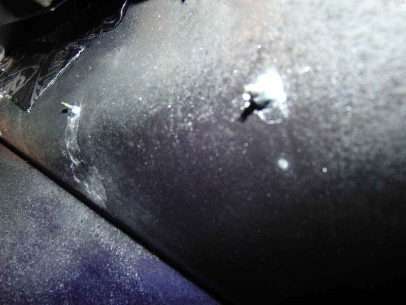

Don't know what you are working on. I have a 1970 Dart. I just reached up to the back of those locations over the rear wheel well in the trunk. There are actually openings in the bracing that allow you to get to the ones farthest back in. The farthest one are accessed lying in the trunk. Be sure to look around with a Big Flashlight for the best access for each nut. I just took these pictures for you:
The white stuff is from the paint shop when they buffed out the paint with the trim removed. Rubber ring on the post clips seals the holes nicely. Good Luck
