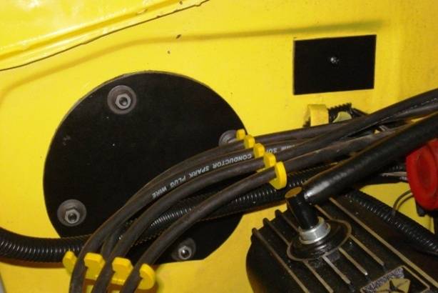

I made my own, looks original!

So I decided to build my own Heater delete option. I went to a local Plastic company and bought a product called CELTEC. This comes in various size sheets, colors and thickness. It can be drilled, cut with any type of blade (not like Plexi-glass).
Here are the results with a 3 x 4 sheet (got extra for the back seat-to-trunk divider) was only $18.
With this I made the plates for the Heater motor, Heater hoses and heater controls.
Here is a link to the product...
http://www.cpg-vycom.com/celtec.asp
Aloha, Mike!:cheers:
