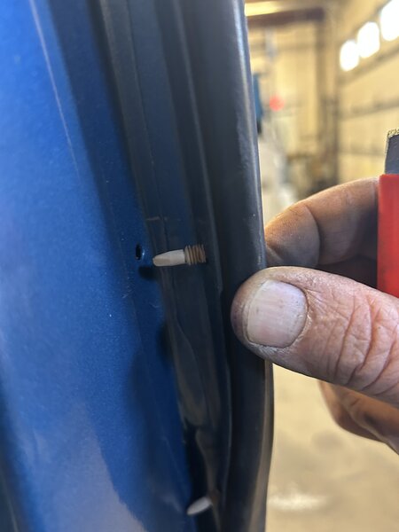

So on this 86 Dodge Ram van with two rear doors the weather striping is in awesome shape. It is held in place by what looks like 50 push in “t” style pins.
I need to take the weather striping off to repaint the doors. I was going to buy new weatherstripping- but the cost floored me. I cannot get access to all the pins from inside the door to push them out. Can you buy new weatherstripping strip “tee-pins” and if yes- where? I thought about taping off the weatherstripping and paint around it. But not my normal way and it feels like A$$ doing it that way. But at $300 for those two doors alone- is there another way? I bought new for the front doors but they were shot due to bad hinges. I bought new hinges and repainted the jams. Ugh! I just don’t want to spend the money.

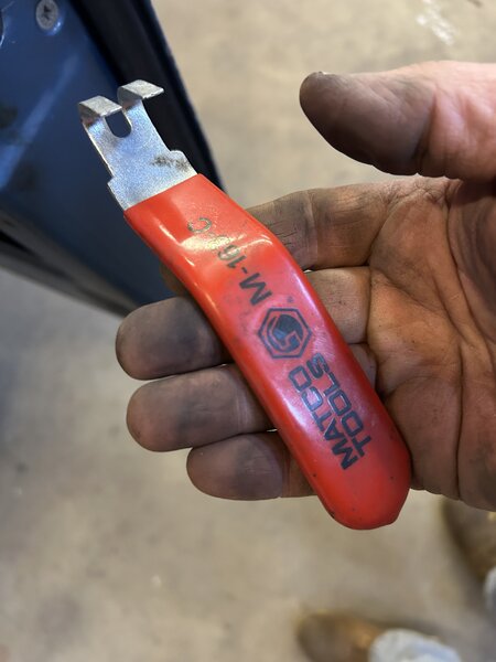

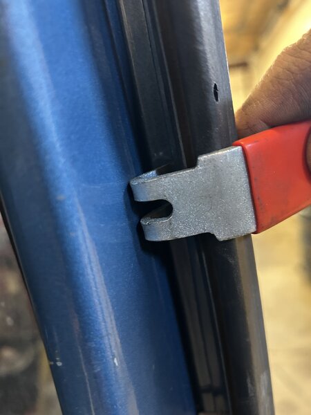

I found in my tool box a tool I bought possibly 30years ago for interior work back when I was a GM mechanic.
It works great taking the pins out. Take a look:
