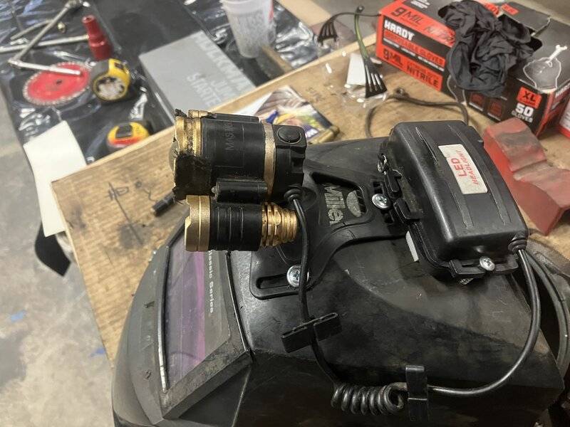

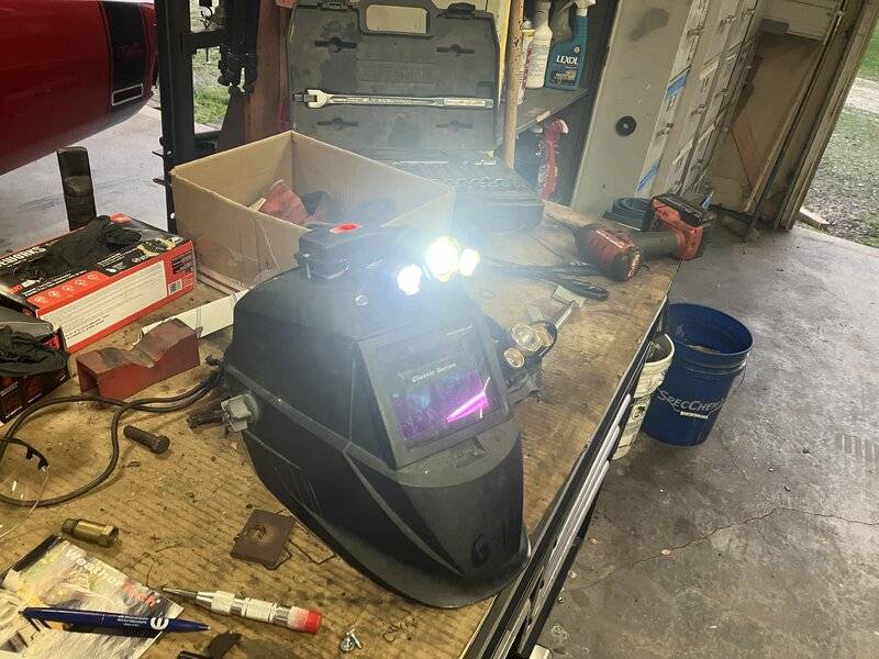

I stopped at the local welding supply to see about a welding hood mounted light. They had nothing. At home, I made this:
It is fairly simple. Back when I was still working in construction, we often started work before sunrise and needed light to see and work. We al started wearing those LED lights attached to an elastic band with power supplied by rechargeable batteries. I just cut the bands off and screwed it to the hood…
Once welding starts, the lense darkens for protection but before and after, a dim area makes it hard to know where to get started.

You can get these lamps on Amazon for around $20. They really are bright enough to work in the dark.
Rechargeable batteries are great for something like this. You could make brackets to hold a standard flashlight to the helmet, some are lightweight so you may not even notice the added weight.
Try using the headlight you made for your helmet and cut down on the light behind you that can be sneaking into your helmet.
all your light needs to be Infront of you at the weld.
Nice! It's good that you're branching out of the comfort zone. Many people are too proud to learn a new skill. That light will be very handy. I have a similar head lamp mounted on my welding hood. It may be in the way if you ever plan to weld in tight quarters like a roll cage, mini tubs, etc., but at that point though, looks like you made it so it can be easily removed. Then you can just set up a spot lamp or something.

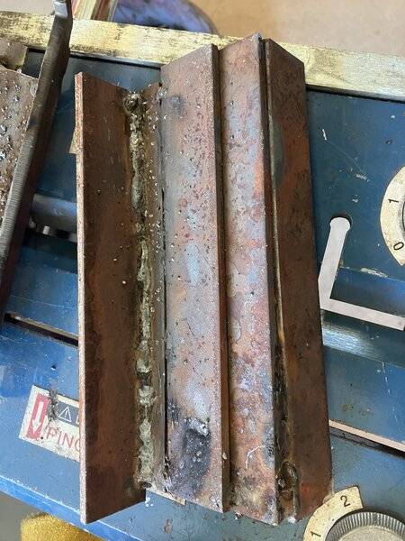

This past month I started a welding class with another FABO member. This week we did some stick welding, a type that in my opinion, is obsolete for what kind of stuff that I do. I took the class to improve my MIG skills but this class is geared to exposing students to all the common welding techniques. SMAW, GMAW and even TIG. My skills at stick/arc welding are not good but improving. It was so frustrating , I would have quit but I heard that next week (week six of eight) we focus on MIG!
I'm taking the class along with Greg. I've never welded before and I wanted to learn so community college seemed like one of the better choices. Monday we started stick welding with 7018 and 6010, and I was probably more frustrated than Greg. Just about every time I struck up the electrode it would stick to the material. Today went much better, and even though my welds suck, I was at least able to run a bead across the seam. The 6010 is much more unforgiving than the 7018.

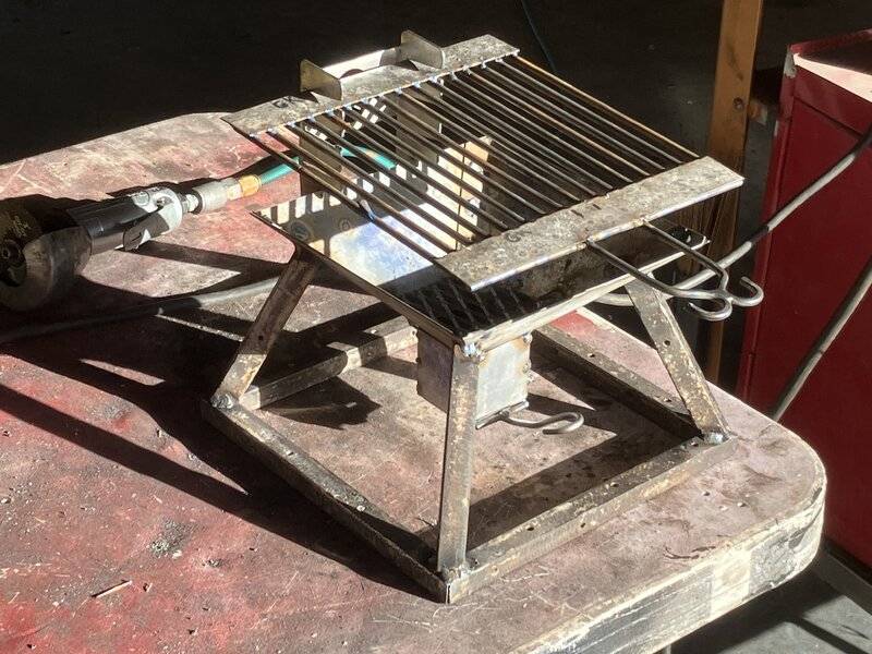

The first four weeks were spent learning terminology, symbols, techniques and fabrication. They had us build mini-Hibachi grilles….
They had “plans” we had to follow to cut and shape the sheet metal. The designs of the bases were up to each student to come up with.
Looks a lot better than mine.
I like the idea. I just wonder about the extra weight sitting on top of the hood.

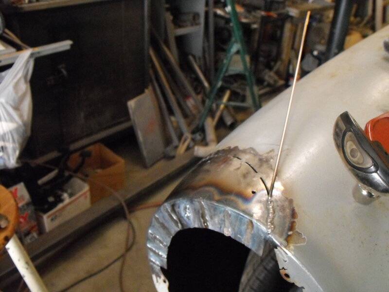

That`s a tig rod friend. Mr ??? is focused on that I guess, the light is at the far right of the picture. lol
Well you fooled me.
I will continue with my 110 Lincoln MIG for sheet metal if that is what a tig weld looks like.
:poke:
When you get 6010 down you’ll love it. I use it for root passes and 7018 for cover.
My ??? pertained to the lamp on a hammer instead of on the hood. These lamps weigh less than a pound, you don't even know that it is there.
:poke:
Both get ground down, and tig has less heat/warpage. If you never tig before, you shouldn`t diss someone's welds. I`d put my welds up against anybody's :rolleyes:

They do make hoods with built in lights now, I believe.

I read the 12 lb part and skipped over the "magnet" part. Still, a lamp on the hood will help in low lighted areas because the lamp will follow my eyes, no need to reposition it. I can appreciate the way you did it, it is another approach worth considering.
Also...All welds by amateurs like me need some manner of "spit and polish" after the fact. If the welds have good penetration and aren't like mounds of licorice, I'm satisfied. I can always tune up the welds after the fact. I'm not looking to do this for a living, I just am a hobbyist like most of you.
When at the welding supply today, the man opened a catalog and did show just ONE hood with a clip on bracket for a cylindrical shaped flash light. Unfortunately, those may not provide a wide enough beam of light for me. I came home and just thought that the 3 bulb lamps I've used for years in wood framing should also work for this. If this idea helps others, all the better.
