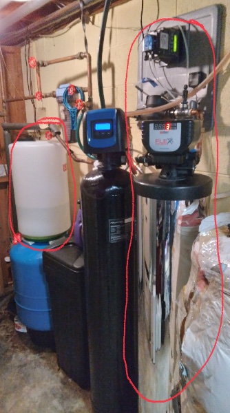

Our well is 175 feet deep. It has the sulfur smell and high iron content. The smell used to come and go and we got used to it. But, the iron would come out of the solution and stick to my wife’s blond hair, turning it strawberry blond. She complained about this for years! I finally bit the bullet and bought this $3,200 hydrogen peroxide injection system (the parts circled in red are what I’m talking about). The hydrogen peroxide makes the iron come out of solution so it can be filtered out before the faucets. It also entirely neutralizes hydrogen sulfide, so there is no longer any smell to it. Also, we stopped using our salt recharge water softener because the hydrogen peroxide system does even better on its own. I no longer have to carry 40 pound bags of salt to the basement. Now it’s just carrying 2.5 gallon jugs of 7% hydrogen peroxide.
I recommend replacing the sacrificial anode in the hot water tank first and if that doesn’t solve your smell problem, you may be looking at a more expensive solution.

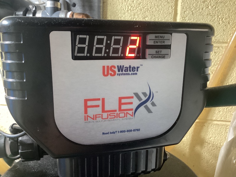

I've never heard of the hydrogen peroxide system (no reason I would have, actually), but I'm intrigued enough that I'm going to be looking into this ASAP, starting during my lunch time today!

On sale now! Eradicate Iron & Sulfur from Water with Matrixx inFusion System
