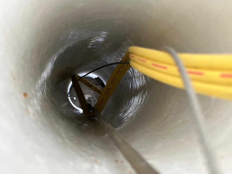

One mystery solved. They tried running a camera down the well casing this afternoon, but they only got down 4-5 feet before they found the well casing was not only cracked, but completely broken, leaving the well open to the topsoil. Both of the guys that were here said they’ve never seen this before…..
Picture taken from the top of the well casing with my phone. The light is from the camera, and the black area at the 2:00 position is the broken casing.
Picture of what the camera shows:
That's ugly... gotta make you wonder if somebody backed into it at some point in the past.
We all stood there and looked at this….and looked at it…..and looked at it…..and looked at it some more. No ideas!
