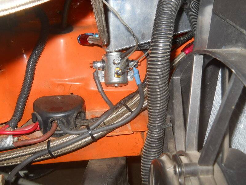

I have a micro switch on the carb with a normally closed relay wired in, at WOT it turns the alt off. I don't do it for speed I do it for consistency. We braket race and we double enter at pretty much every race. Lots of times we don't even stop at the trailer before we go back to staging. So with the battery at different states of charge it effects how much power it takes to spin the alt. It's not much. But in the current state of braket racing .0001 can mean the difference between winning and losing.
