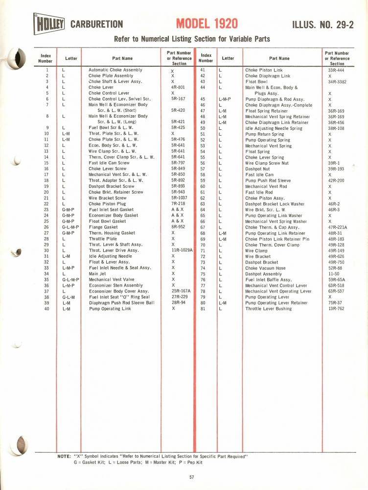

Holley.com, go to the carb list numbers.
A picture would certainly help identification. CFM wise, if it came on a slant, not much.
from The Old Car Manual Project website
Do you know how i can find the year of my Carb?

PERFECT! thank you so much that is exactly what i needed! and the carb is exactly the same! (the first thing you posted was a different carb)
