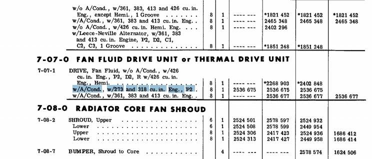

They do exist! part number 2536 675 in 65 parts catalog. Its not even pictured in diagrams. check post #38

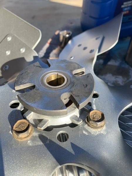

Here is the OE 2536 675 clutch unit next to the Hayden 2947 that mopardude318 suggested... I had to use the 2947 Hayden when I installed the thicker Aluminum Radiator...
All I can say is the New Hayden 2947 has worked Very Well !!!

Also like pishta's 65 Parts book photo that shows the 2 piece metal Fan Shroud part #'s
I just went through this. The car (‘64 Valiant 2743/4spd) had a fan clutch on it when I bought it. I changed to an aluminum radiator and the brackets pushed it closer to the engine. I had to use the 2947 clutch to get it to fit. Then the fan was clipping the upper hose. The problem was the upper hose is more centered then the stock radiator. I ended up getting a flex a lite #6717 17in fan. That’s a fan clutch fan. One other thing... you need to run the spacer on the water pump. Make sure the spacer isn’t too long. I had the file mine down, as it was causing mine to wobble because, I couldn’t tighten it down squarely.
