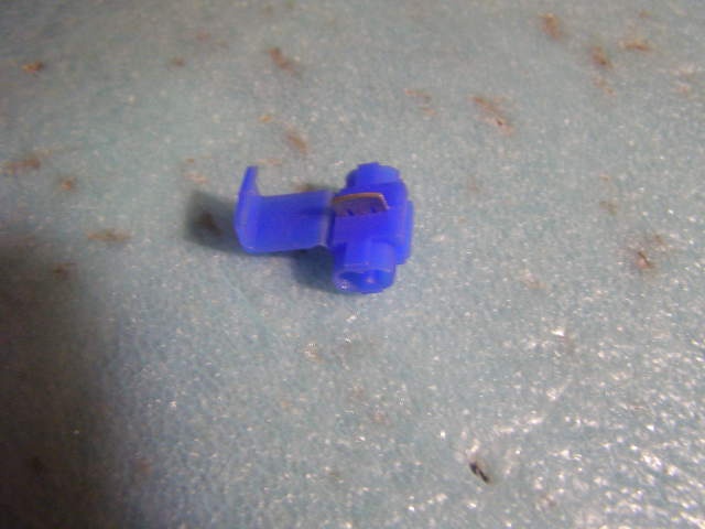

What I did for my LEDS
i still need to connect the brake light switch and get the correct flasher, but you get the idea.
