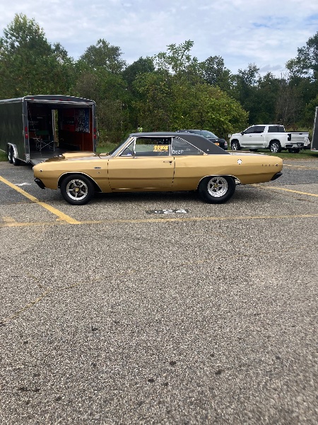

I run a P295/65R15 Hoosier drag radial on my Dart a few of my friends run the same tire. I got away from slicks when I moved to a DOT required tire class , at first I ran Hoosier Quick Time Pros at 10 lbs of pressure , I switched to the drag radial a few years ago and I like them I run 18 lbs of pressure and the car is more stable top end. The class rules changed and I can run a slick now but I like the drag radials. My car runs high tens with low 1.40s 60 ft I run on a throttle stop to run 11.50s and my 60 ft is 1.46-1.48. When I did run slicks a radial slick was faster than a bias ply but as others have said IMO also they tend to wear quicker and can be tricky on a marginal track. I just put a new set of drag radials on about a month ago. I run a M/T 275/60 R15 drag radial on my low 15 second 92 D150 p/u they work well also. My Dart is mini tubbed , narrowed 8 3/4 , springs moved into frame rails with Cal Tracs , I run a 10 inch Holeshot wheel with 4 1/2 inch back spacing
