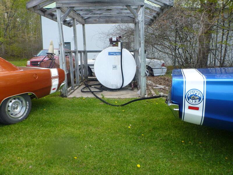

Pump 91, plus a few gallons of 100LL avgas, (cause I have access now) in my iron head 10.5 to one 440. The 100 avgas in Arizona is cheaper than pump premium at a name brand station in california.
