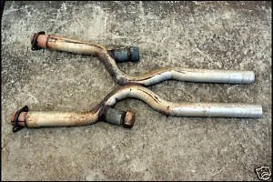

Home made one here. It doesn't look like that anymore. I have cleaned it up and repainted it.
