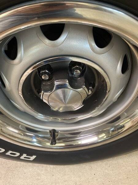

Had a flat today and the end of my wheel wrench is to large and marked up the paint on the centre of my rims.Would any one know the color of the paint on a 73 dart rally centre.Any help would be appreciated thanks
This color seems darker and I don’t think they were painted but I could be wrong on that .
