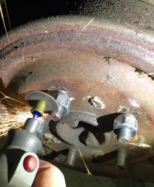

3 – cut three threads off of the stock studs to ensure they don’t protrude beyond the wheel adapter. (note: they’re still long enough to reattach the stock wheels)
