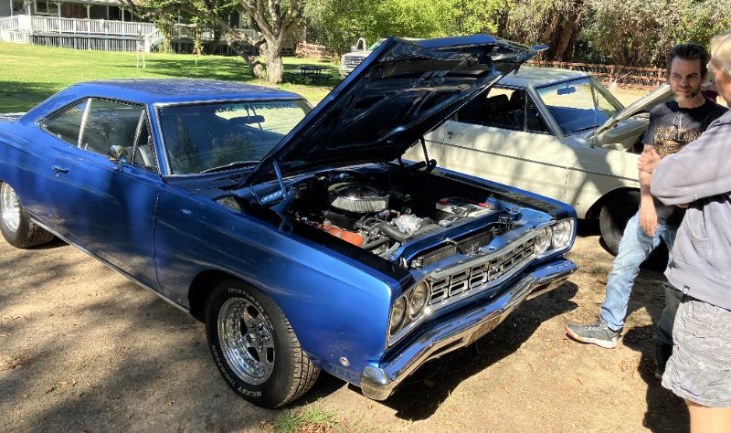

The dark haired guy is Dwayne, known at FBBO as 68 Sport Satellite.
His Plymouth is incredibly clean. I did a Borgeson steering box in it in 2023 along with a Vintage Air installation.

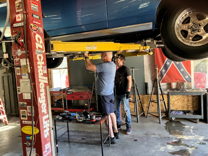

It was Torsion bar day for Dwayne/68 Sport Satellite. John in blue...(FABO member @jbc426 )
He went from 1.0 bars to 1.06s.
The bars swapped out easily. The hardest part was forcing the grease boots over the hexes at the end of the bars.
