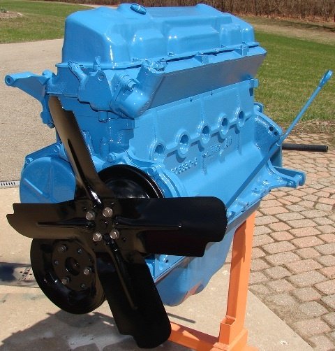

It takes a little doing in the head, the right piston/rod combo, the right cam, but its not to hard. The / is a great engine, and needs some TLC to make it run great.
All the/ guys on hear already know that :wink:
The engine as your looking at it, as a long block, was around $4000. The customer supplied the exhaust, intake and other little things to finish it out.
Those pistons are KB Hyper dish.
Yeah Ed, see the "D" cup? that's why I said that other piston you were lookin at aint gonna have much quench. But that D cup or a flat top will.
cant 0 deck a flat top in a slant and expect to run on 87 lol...
EDIT... those have an 18CC dish? and are "near" 0 deck... i would be able to 0 deck with the ones im looking at and have the same CC dish...
We did this one last year. 250-275HP
Man,You cannot put out eye candy like that with out some specs....
What pistons, cam,rod,bore,compression.head flow...?
You know we want to copy it !!!!
