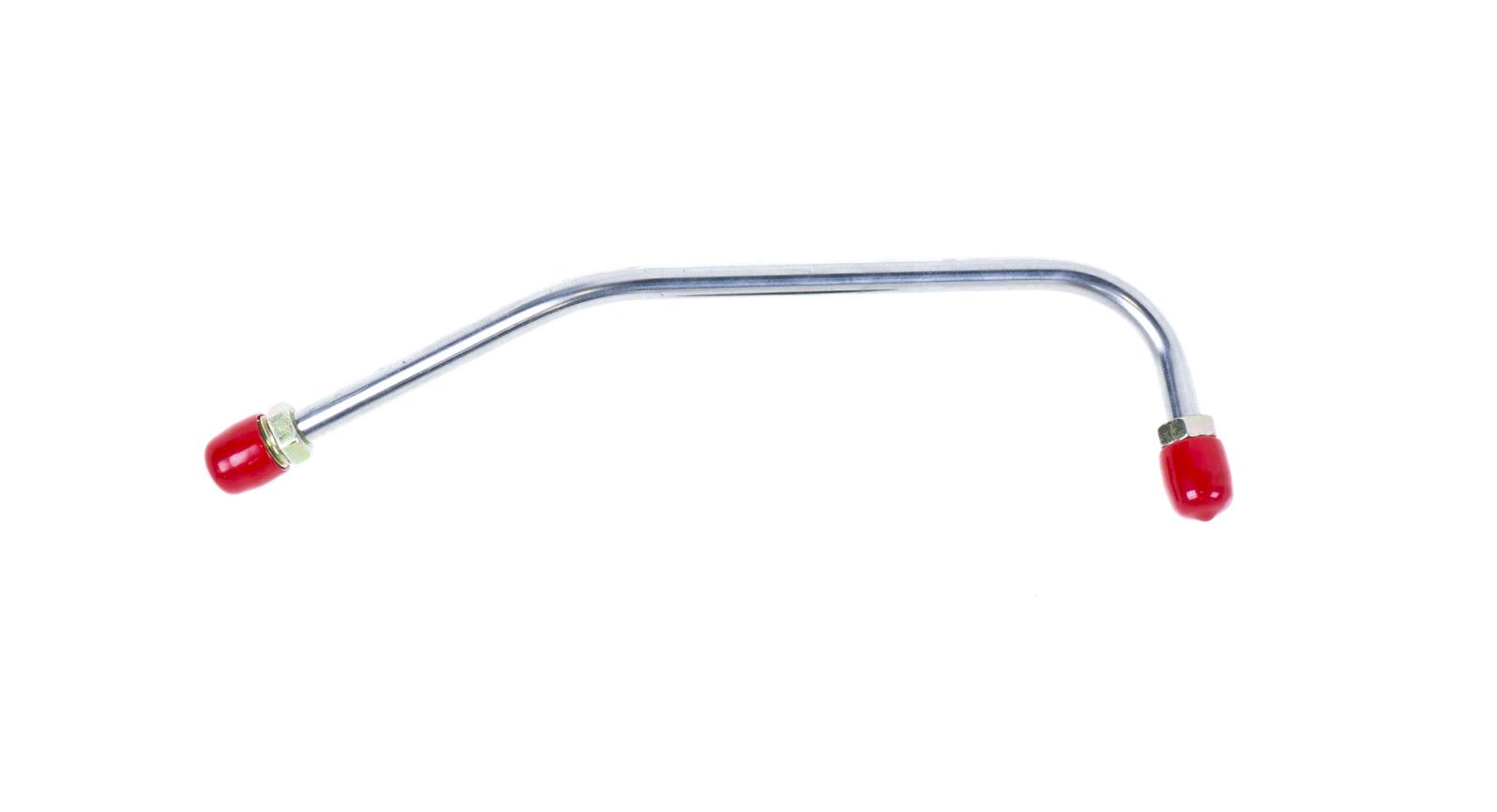

or something like this in addition to the line you already have

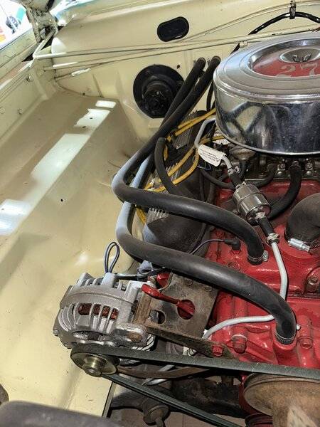

I went ahead and made up the lines myself. I had a new 5/16 Edelman 4' line from a past project that was flared with nuts on both ends. Making the U turn from the fuel pump was challenging, but I got it done. I'm getting a Mopar fuel filter, once installed I'll post pictures. I tried Rusty's suggestion with the coat hanger wire, it helped me figure out the bends and allowed me to determine if I had enough tubing. The 4' tube was just right with a bit left over. I still need to make the bubble flares on the filter ends. Thanks for all the support guys!
Here's the end product. I ended up doing the upper line twice, I didn't like the 90 on the first attempt. Turned out great, those angles are challenging to get right. I followed Professor Fate's advice and used the die to make the bubbles for the filter ends. These lines (straight with flared ends and nuts) used to be easy to get in parts stores, now the ones they carry have a coating over them. I was able to get an 18" line from Rock Auto to redo the upper one. It was a Dorman Fuel line repair type came with a different fitting on the end but I just cut it off and flared the line and reused the nut I had. Otherwise you have to buy the line in 25' coils.
