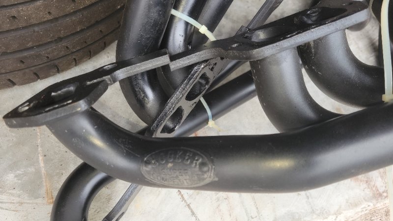

It could be that headers may actually be less work, and considering how much some people have been asking for 340 manifolds lately it may not be too much more expensive. Read the fine print from the mfrs. closely though for 4 spd. fitment.

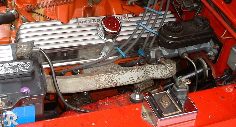

I ran 340 exhaust manifolds on my 65 Barracuda 4 speed for years, early and late. Tried different things but what worked best on the driver's side was manual steering box with power steering column and an adapter to mate the two. That moved the joint back out of the way of the manifold. Then run the outlet down between the torsion bar and the frame. On the passenger side, the late center outlet fit perfectly. The early rear outlet touched the inner fender at the bulge for the upper control arm adjuster (just one of them). Used a hammer to clearance that, but it was still very tight.

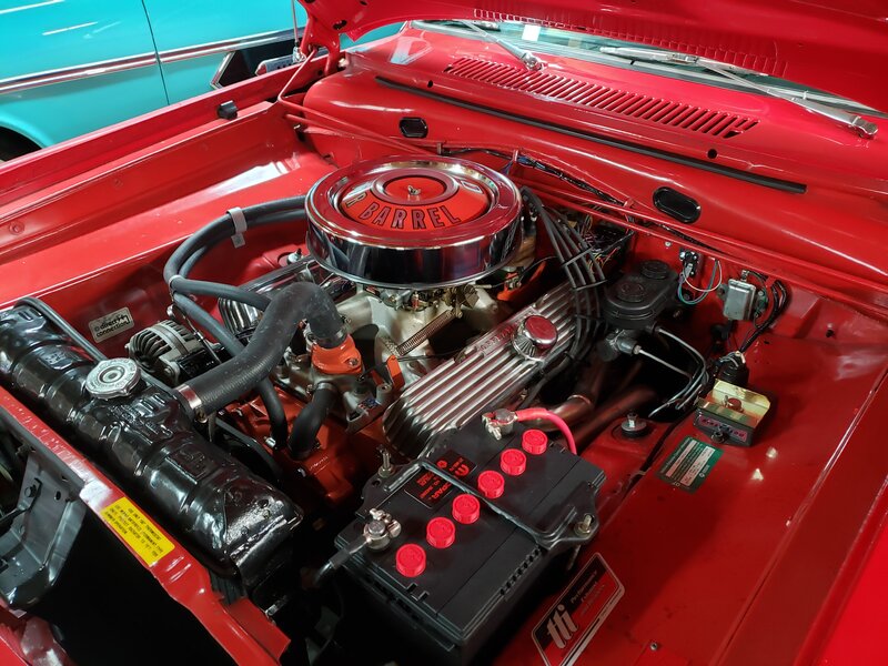

Been running TTI headers for a few years now. They fit, but the installation was a lot more involved than using 340 exhaust manifolds. Went back to manual column with the housing shortened, re-routed brake and electrical lines, replaced my home-made clutch linkage with Brewer's, etc., etc.
