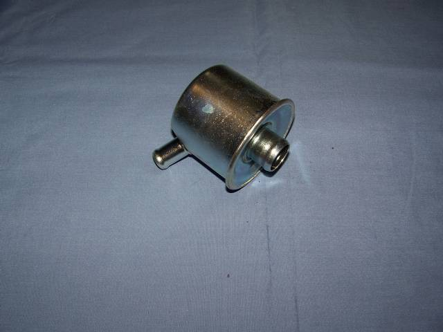

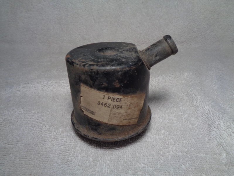

From the book, the part number is #3462 094, but I have seen two different styles for that part number. I have both, but I would rather put the correct one on my project 74 Dart Sport.
I think it is this one:
But other sources show this one:

The crankcase breather, or inlet air cleaner, with the single connection nipple, 3462094, was used from 1970 - 1979 and looks like your first picture. It was replaced for 1979 - 1980 by a similar breather, part number 5214561.
Crankcase breather, 4273322, replaced 3462094 and 5214561 for 1981 and was in use into the 2000s. 4273322 looks like the second picture. 4273322 superseded 3462094 for replacement in earlier applications. It looks different but is functionally the same.
The style of crankcase breather in the first picture was originally used on a 1974 360, but it was painted black.
