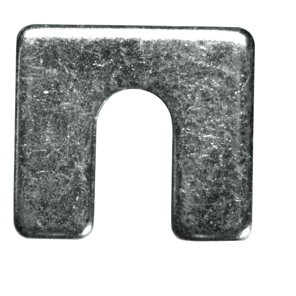

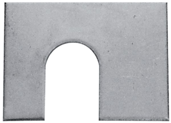

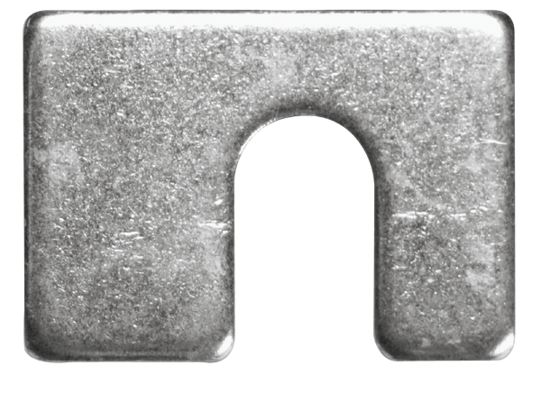

I need to buy the correct fender bolts and shims to bolt the bottoms of the fenders (behind the front wheels) to the car. If anyone could tell me where to get the proper bolts, that would be great, but I am also unsure of which shims. I am looking at Yearone, which offers 4 different types. I am not necessarily going to buy them from here, but I'm just curious which ones I should be using.

You need whatever will give you the correct panel alignment. Any of the above could work but thickness is what will matter.
I just got done mocking up the front end of my Demon. Just used round thick ones and stacked them up till I got a good panel alignment. Can get stuff like that at the hardware store.
