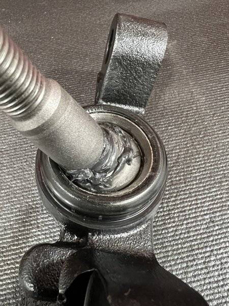

And you can see it when you pop the boot off. Maybe not well enough in the pictures to make believers out of the skeptics, but it’s easy to see when you’re looking at it that everything in there is metal, as is claimed by Proforged.

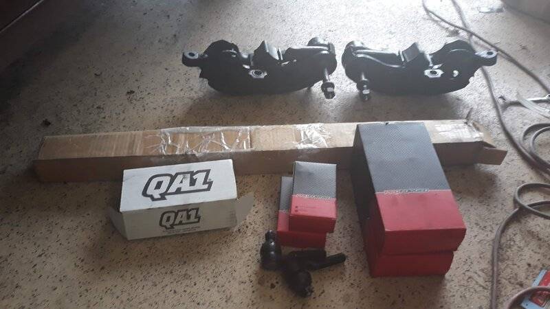

Full parts list below.
Edit: @4spdragtop asked a good question.
73+ Ball joints, 73+ bbp disc spindle, 72 pitman, 11/16 tie rods and adjusters

Everything else is the same thing I used except the T-Rod sleeve. The one I got is from QA1, 11/16 thread. Here it is in comparison to OEM sleeves in the second pic.
*The long box is the PST's 1.03" Torsion bars I installed with everything else a while back.*
