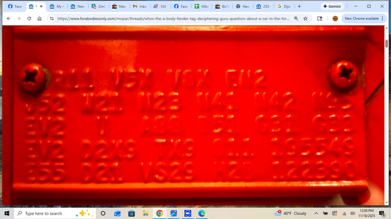

So, after looking at the tag looking for a V5X which I found I thought I would take another look... The tag being posted upside down made me not really pay attention to it prior to this evening...
So, I edited it by rotating it 180 degrees....
Nice clean tag, some nice options.... But one code I would really expect to see isn't there.... H51... A/C.... The firewall is clearly an A/C firewall...The thread title mentions A/C... Some codes vary from plant to plant & year to year... But A/C is a major code that requires a different firewall... I know B & E bodies better than A bodies so maybe I got this wrong.... Who's the A body codes Guru around this website??

If it was an AC car, it should have H51. Never know, maybe someone grabbed an ac kit off another car and installed it.

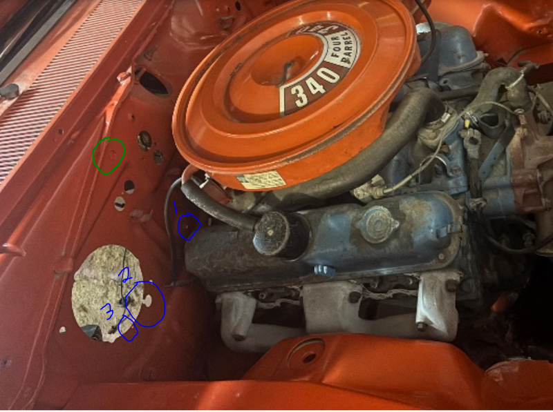

I converted a 70 Dart 40 years ago, the cut out for an A/C car leaves incorrect holes from a non A/C firewall.... They could have been welded up... but I see no evidence of that.... And the seller claims original paint... Just seems fishy to me...

Since everything is out from under dash and engine compartment has fresh paint it could be the firewall was converted to AC? Without H51 on fender tag that firewall needs a close inspection. And what all parts are included or missing is not clearly stated. Floors underneath have fresh paint. Car needs an in person inspection. Car looks like it has a lot of potential though.

Well, one of two things on the a/c. The code was missed in the tag by the factory or someone cut it (the firewall) out and added A/C. I think it was the latter

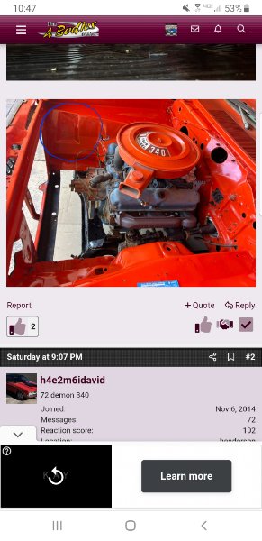

I think its extremely obvious it's been painted underhood, and underneath, zero question about that. One thing I wondered about, is this area of the pass side inner fender. Was this a 72' up thing? I dont remember seeing that on earlier cars. Probably for the charcoal canister mounting.

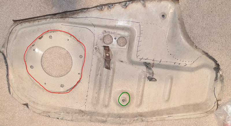

67 AC firewall
RED holes are AC specific
GREEN arrow points to standoff where a hole would be on a Heat only firewall for insulation pin
BLUE arrows point to where I modified the OEM holes for clearance for an AC to Heat only adapter plate
68 Heat only
RED is the heat only opening
GREEN is the insulation pin hole
ALL other AC specific holes are not drilled
Things that make me think the AC was added on at some point in its life (dealer or owner)
BLUE Circle #1 hole punched for the heat only insulation
BLUE Circle #2 lower mounting hole has remnants of the original heat only hole (where I had to cut out of my AC dash for clearance)
BLUE circle #3 1 of 4 small holes from a heat only firewall. On my adapter 3 of the 4 small holes are visable and only the lower hole is hidden by the AC firewall.
GREEN circle looks like there is a hole there but taped or something from the back side.

So it appears to me that it is on the fender tag (G31). Would that mean it was an A/C car ? Why else would this be on the fender tag ? Or my eyes are lying to me . After all my eye's aren't what they once were
That is C31 G33 is the G code.
the tag shows G31 (might be C31?)
But that's not G 2 1
I am 99% sure it's not a factory AC car. Too much evidence to the contrary.
