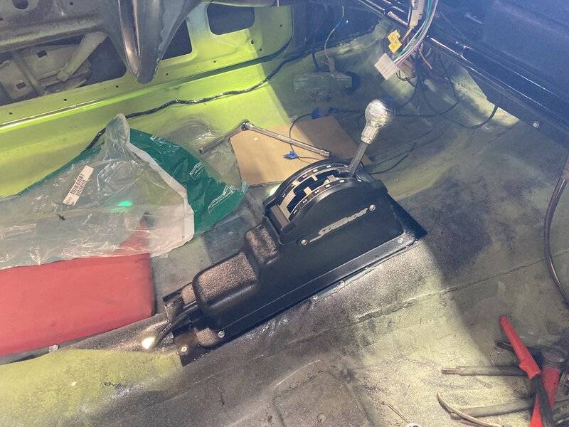

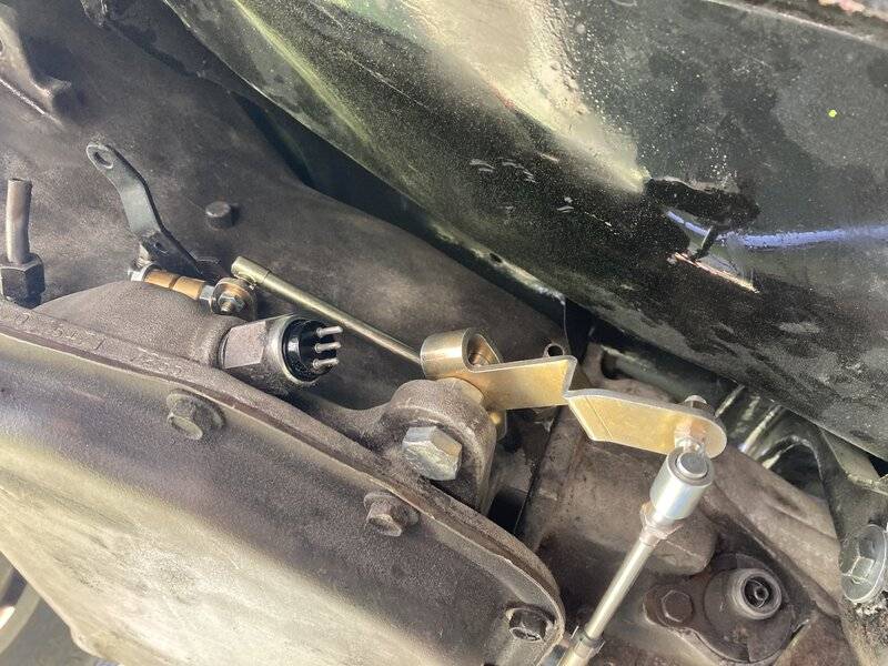

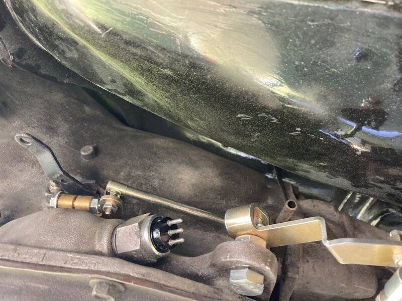

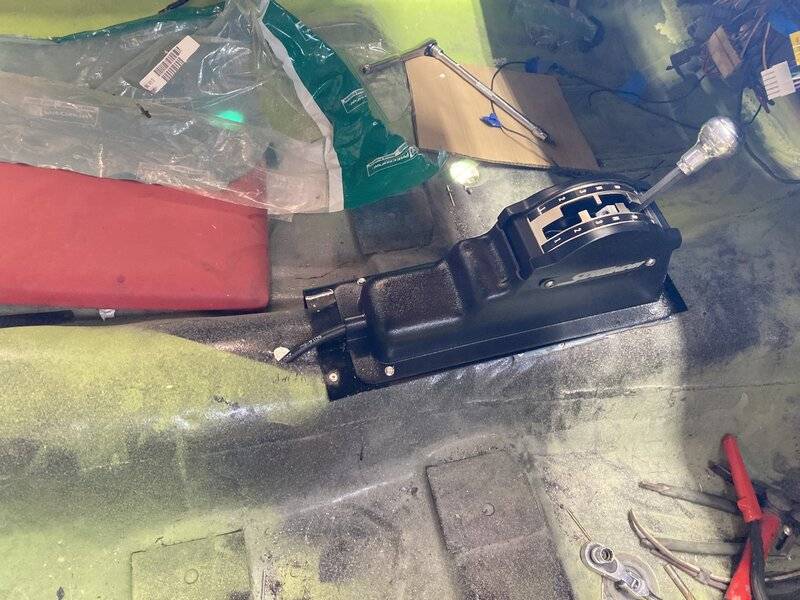

Does anyone have pics of the sidewinder hooked up to a 727 from under the car? I'm having a hard time installing the bracket to the trans. It doesn't seem correct to me. Installing it in a 75 duster with 440.
Thanks
I figured it out. Yeah I’m worried about is the exhaust is gonna be in the way now.
Drill a hole in the front and rear of the cross member, put a couple of grommets in it and run the cable through the cross member. It will look much more professional and keep it up and out of the way of the exhaust. There's also some heat shield sleeve you can put over it. Like the stuff you put over plug wires when they run close to headers.
