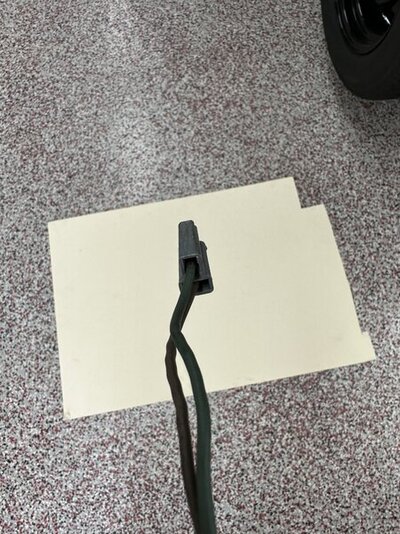

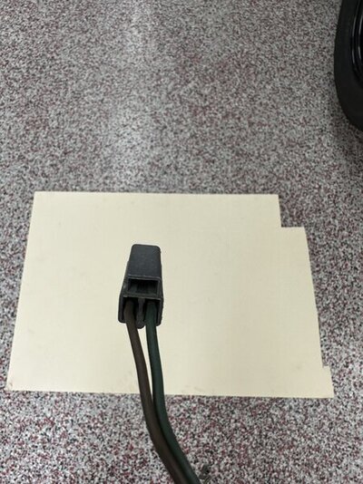

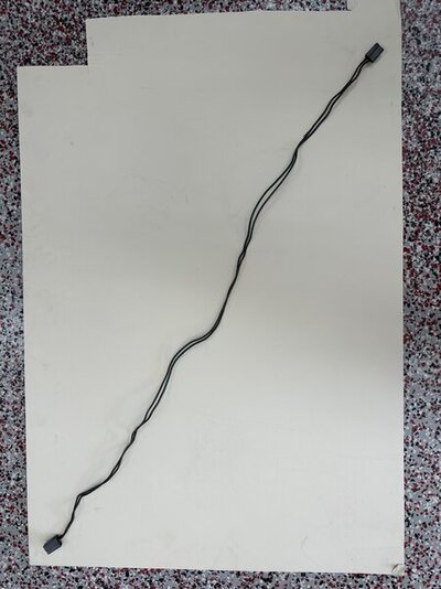

Does anyone have any idea where these wires connect to?
1972 Plymouth Scamp, 225, Auto Trans, 7 1/4 rear end. The wires are DG & BRN, connectors are GRY. Both connectors are female, 1 is a dual connector other is a 3 connector. 3 connector has only 2 wires. I believe that this is in the passenger compartment under dash as that is where I had this combined with other wires form the harness. It is approximately 39” long.
IMG_0191.jpegSorry to be so long just trying to give as much information as possible.
View attachment 1716162710Sorry to be so long just trying to give as much information as possible.
BTW I have a FSM and several other wiring diagrams I have consulted that have been of no help
I believe it goes between heater blower switch and resistor.
