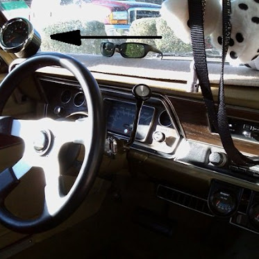

An easy place to mount it is on the drivers side pillar - there is a screw that holds the pillar trim on, just mount it there - you can run the wiring down the side of the dash, and then to the underside of the dash. I did this with my Sunpro Super Tach II with 3 3/8 inch face. That puts it right above the dash pad.
Here it is in the location
